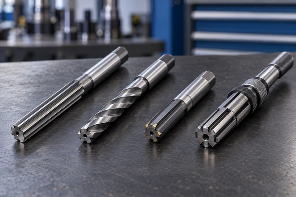

  • Straight flute reamers: Often suit interrupted cuts and general purpose holes.
  • Spiral flute reamers: Help move chips from blind holes, depending on helix direction and setup.
  • Machine reamers: Are used in CNC mills, drill presses, and lathes for repeatable production.
  • Adjustable reamers: Provide limited size adjustment but are less common for high volume precision CNC work.

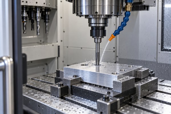

cnc reaming operation
What Determines Reaming Accuracy?
Reaming accuracy is driven by the prepared hole and process stability.
  • Prepared diameter: Leave a controlled, modest amount for the reamer rather than forcing it to remove excessive stock.
  • Alignment: Keep the spindle, toolholder, and hole centerline aligned to avoid bell mouth or taper.
  • Feed and speed: Use the cutting conditions recommended for the material and reamer type. Reaming normally uses a positive feed without dwell.
  • Coolant and chips: Good lubrication and chip evacuation protect surface finish and tool life.

reamer tool types

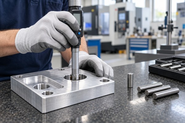

Which Quality Controls Belong in the Plan?
Quality control for reaming machining is a stack of material, process, and dimensional checks.
  • Incoming control: Verify material identity and condition before machining. This prevents a correct program from producing parts in the wrong alloy or hardness.
  • First article inspection: Measure the complete first setup before releasing the batch. The result confirms both the program and the datum transfer strategy.
  • In process checks: Monitor tool wear and the dimensions most sensitive to runout, excessive allowance, chip recutting, chatter, and bell mouth. Scheduled checks are more reliable than waiting for the final inspection to reveal drift.
  • Final verification: Report finished diameter, roundness, cylindricity, position, and surface finish using instruments with suitable resolution and calibration status. A quality certificate does not replace part specific evidence.
reamed bore inspection
