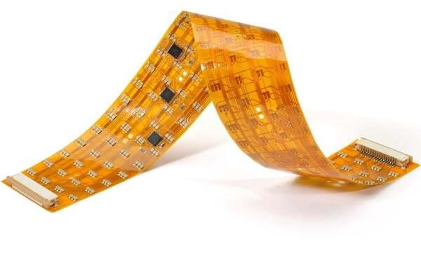

What is a Flexible PCB?
A flexible PCB, also known as a flex PCB or flex circuit, is a printed circuit board made with thin, bendable insulating materials such as polyimide. Unlike rigid PCBs, it can bend, fold, or conform to the shape of a product while maintaining reliable electrical connections. Flexible PCBs are widely used in modern electronic devices, including smartphones, wearables, medical equipment, automotive electronics, and other products where space, weight, or movement is an important design consideration.
Key characteristics of flexible PCBs include:
  • Flexible Construction: fits into curved, narrow, or irregular spaces.
  • Thin and Lightweight: helps reduce product size and overall weight.
  • Reliable Connections: replaces bulky wiring and reduces the number of connectors.
  • Movement Resistance: can support vibration or repeated motion when properly designed.
  • Design Freedom: allows components and circuits to be arranged more efficiently inside compact devices.

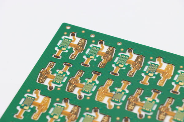

PCBgogo supports both flexible and rigid-flex PCBs. Its standard online quotation system covers 1-, 2-, 4-, and 6-layer flex PCB configurations, allowing customers to source anything from simple interconnect circuits to more complex multilayer designs. Special structures can also be reviewed according to project requirements.
