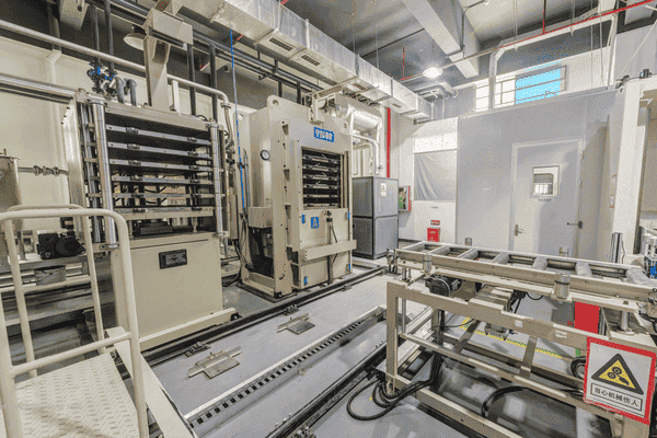

4. Lamination
This is the step that actually makes a multilayer board "multilayer." Inner layer cores and sheets of prepreg (uncured, resin-impregnated fiberglass) are stacked in the exact sequence defined by the stack-up, oxide-treated on the copper surface first to improve adhesion, then loaded into a hydraulic press.
Heat, typically around 175 to 185°C, and pressure, typically 350 to 500 psi, are applied for a full press cycle. The prepreg resin melts, flows to fill the gaps between layers, and cures into a solid bond. A standard lamination cycle runs 4 to 6 hours. Boards with blind or buried vias require additional lamination cycles, one per set of buried layers, because those layers must be drilled, plated, and bonded before the next set of layers is added on top. This is the single biggest reason a 12-layer board with buried vias can take longer to fabricate than a 20-layer board without them.
Registration accuracy during lamination directly determines whether your vias land where they should on every layer. A misalignment of even a few thousandths of an inch across a 20-layer stack can break the connection between a via and an inner-layer pad, and that failure mode is invisible until electrical test.

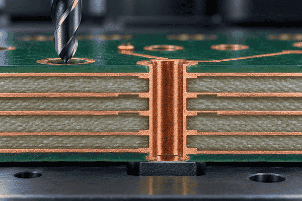

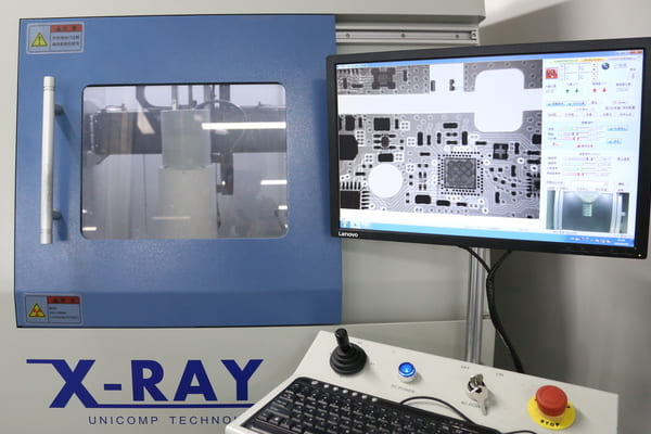

5. X-Ray Registration Check and Drilling
Before drilling, the laminated panel is X-rayed to confirm the internal layers are properly registered to the drill program. Skipping this step on a high-layer-count board is how you get a batch of boards with broken via connections that nobody catches until final test.
Drilling uses mechanical carbide drills for standard through-holes, typically 0.2 to 0.5 mm in diameter, and laser drilling for microvias below 0.15 mm, which is standard on HDI boards. Drilling generates heat that can smear melted resin across the exposed copper inside the hole. This smear has to be removed with a desmear or etchback process before plating, or the copper plating in the next step will not bond properly and you get an intermittent, temperature-sensitive open circuit that is one of the hardest field failures to diagnose.

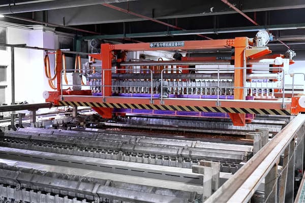

6. Copper Plating
Electroless copper deposits a thin seed layer of conductive copper across the entire hole wall, since the drilled hole starts as bare fiberglass and resin with no conductivity. Electrolytic copper plating then builds this up to the target thickness, typically 20 to 35 microns in the barrel of the via, to create a reliable electrical connection between layers.
Plating thickness distribution across a panel is a real quality differentiator between factories. Uneven plating, thicker at the panel edges and thinner in the center, is a common defect on poorly controlled lines and shows up later as vias that fail thermal cycling tests even though they passed initial electrical test.

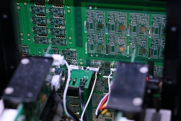

10. Electrical Test
Every multilayer board should go through 100% electrical test before shipment, either flying probe testing for prototypes and low volume, or a bed-of-nails fixture (In-Circuit Test) for higher volume where the fixture cost is justified. This test verifies continuity and isolation across the entire net list, catching opens, shorts, and impedance-out-of-tolerance nets that visual inspection cannot see.

5. AOI, X-ray, and functional test: X-ray inspection is particularly important on multilayer boards with BGA packages, since the solder joints underneath a BGA are physically invisible to any optical inspection method.
