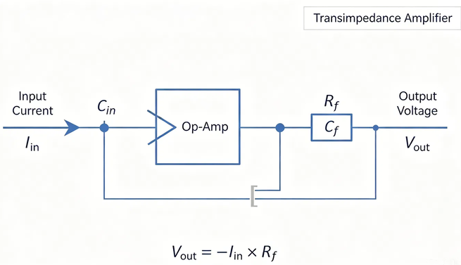

How a Transimpedance Amplifier Circuit Actually Works
A minimal transimpedance amplifier circuit has three components: an op-amp, a feedback resistor R_f, and a feedback capacitor C_f. Here's what each does and why it matters.
The op-amp needs a low input bias current (to avoid adding a DC offset equal to I_bias × R_f), sufficient gain-bandwidth product, and low voltage noise. For precision DC applications, choose a FET-input op-amp like the OPA128 or LTC6268. For high-speed work, look at the OPA657 or THS3201.
R_f sets the transimpedance gain. Larger values give more signal but introduce more Johnson noise (V_n = √(4kTR_f·BW)) and push the –3dB bandwidth lower.
C_f is placed in parallel with R_f. This is not optional — it compensates for the pole created by R_f and the total input capacitance C_in (diode junction capacitance + op-amp input capacitance + PCB stray capacitance). Without C_f, the phase margin collapses, and the output rings or oscillates.
The stability criterion gives you a starting point for C_f:
C_f ≥ √(C_in / (2π × R_f × GBW))
Run a SPICE simulation after calculating C_f. Real-world parasitics always add margin you didn't budget for.
