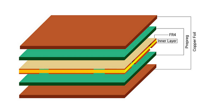

A PCB laminate is the copper-clad dielectric sheet that forms the base of every printed circuit board. It is built by impregnating woven glass fabric with resin, then curing it under heat and pressure with copper foil bonded to one or both sides. This cured sheet, called the core, becomes the rigid platform that carries copper traces, vias, and every component on the finished board.
A finished multilayer stackup is not one material. It is a sandwich of cores, prepregs, and copper foil, bonded together in a single lamination cycle.
Layer ElementRoleState Before Lamination
Core (Copper Clad Laminate)Fully cured dielectric with copper foil already bonded on one or both sidesFully cured, rigid
PrepregBonds cores and foils together, fills gaps between copper featuresPartially cured (B-stage), tacky
Copper FoilForms the conductive traces after etchingRaw foil, not yet patterned
The laminate is not just mechanical support. It sets the dielectric constant that controls impedance, the glass transition temperature that determines how much heat the board can survive during assembly, and the moisture behavior that affects long-term reliability. Get the laminate wrong, and you inherit problems that no amount of careful routing can fix later.

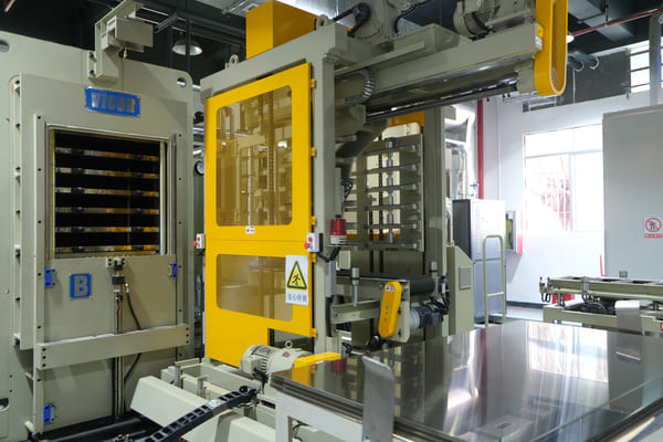

Mixed material stackups without a compatible lamination cycle. When a stackup combines FR-4 cores with PTFE or polyimide layers, each material wants a different press temperature and pressure profile. Running one generic cycle across mismatched materials causes uneven resin flow, voiding, and inconsistent layer thickness. Every hybrid stackup needs its lamination profile verified against each material's press specification before the panel goes into the press, not after a batch fails inspection.

Inner layer oxide treatment before pressing. Before the inner layer cores go into the press, the exposed copper surface has to be roughened through a brown oxide, or in some processes black oxide, treatment. This step converts the smooth copper surface into a micro-rough oxide layer that the prepreg resin can mechanically key into during lamination. Skip this step, run it inconsistently, or let the oxide layer sit too long before pressing, and the resin bond to that copper surface weakens. The failure this produces is called pink ring: a pale halo visible around drilled holes where acid used in later processing has attacked the copper along a weak oxide-to-resin interface. It rarely shows up on inspection right after lamination, but surfaces later during thermal stress or after drilling, which is why oxide treatment quality control matters as much as the resin choice itself.
