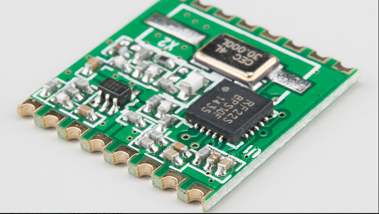

What is a Castellated PCB?
Castellated PCBs, also known as half-hole PCBs, are specialized printed circuit boards that feature plated edge connections along the board perimeter. These “castellations” enable modular designs, making it easy to integrate the PCB into larger assemblies or to connect multiple boards. They are widely used in IoT devices, modular electronics, and high-density PCB applications.
